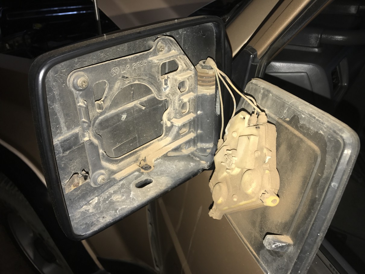

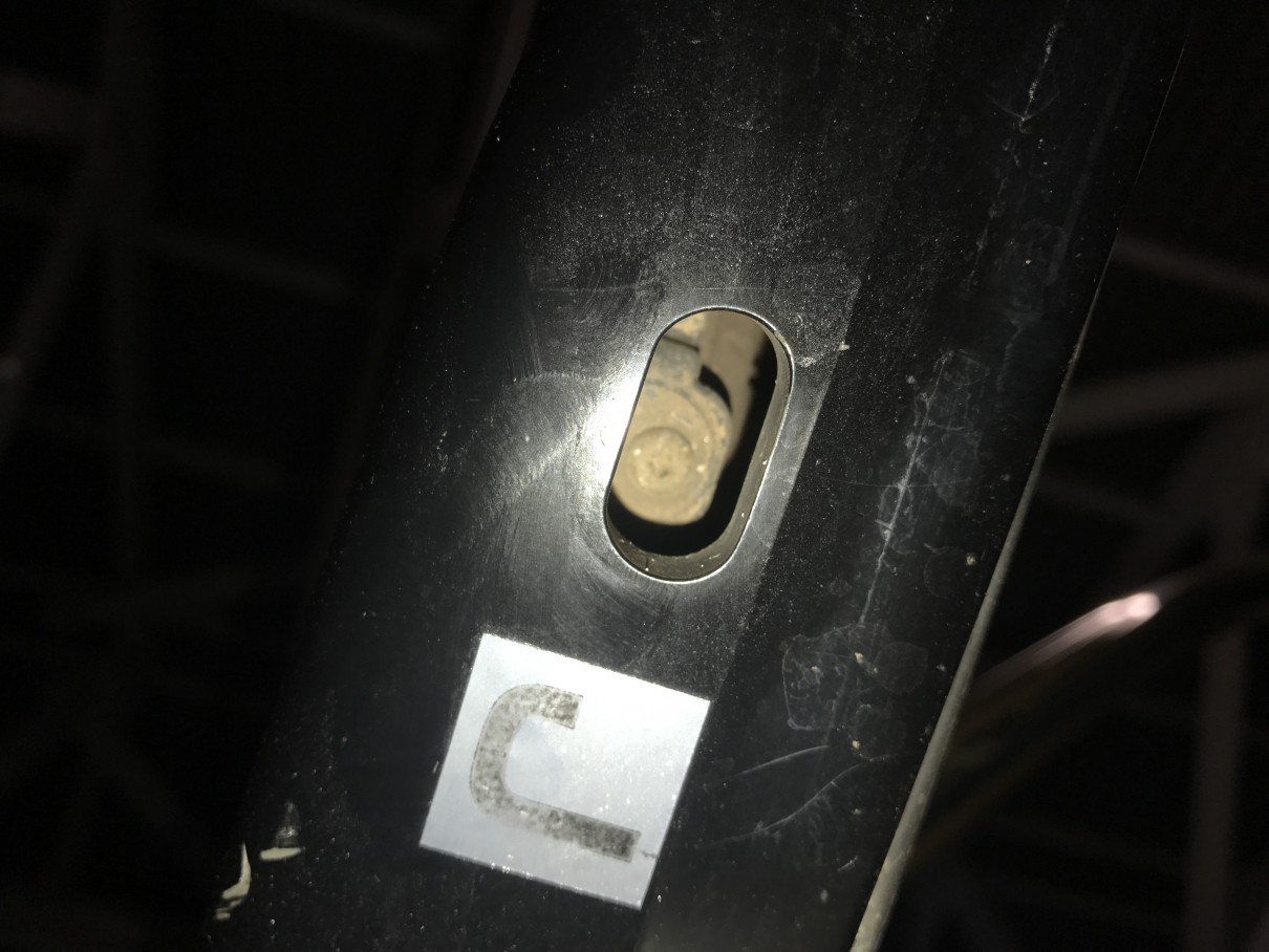

Undo the single screw at the bottom of the mirror housing.
Lift the mirror up and then out, there are small hooks that are suppose to hold the mirror in place. Both my outer hook's catch on the plastic side had broken probably due to the plastic becoming brittle over time.

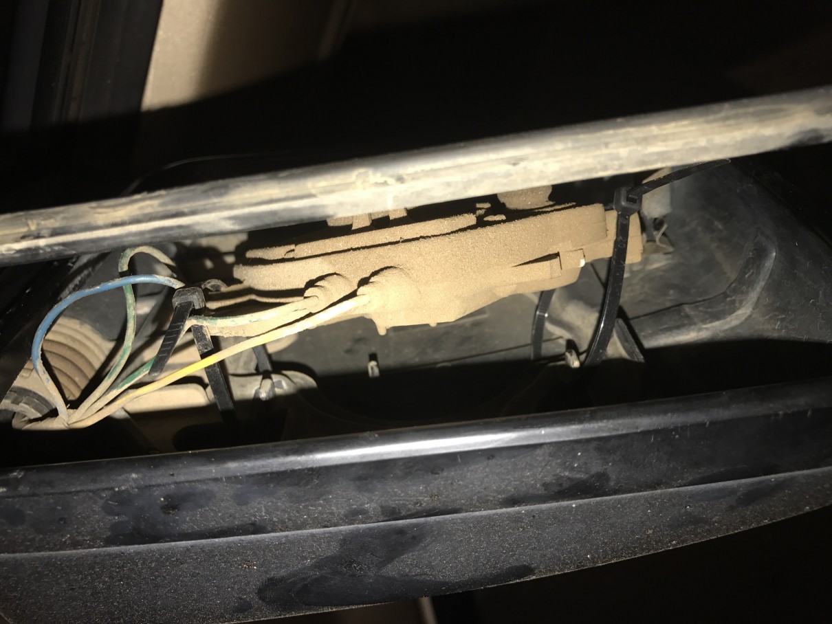

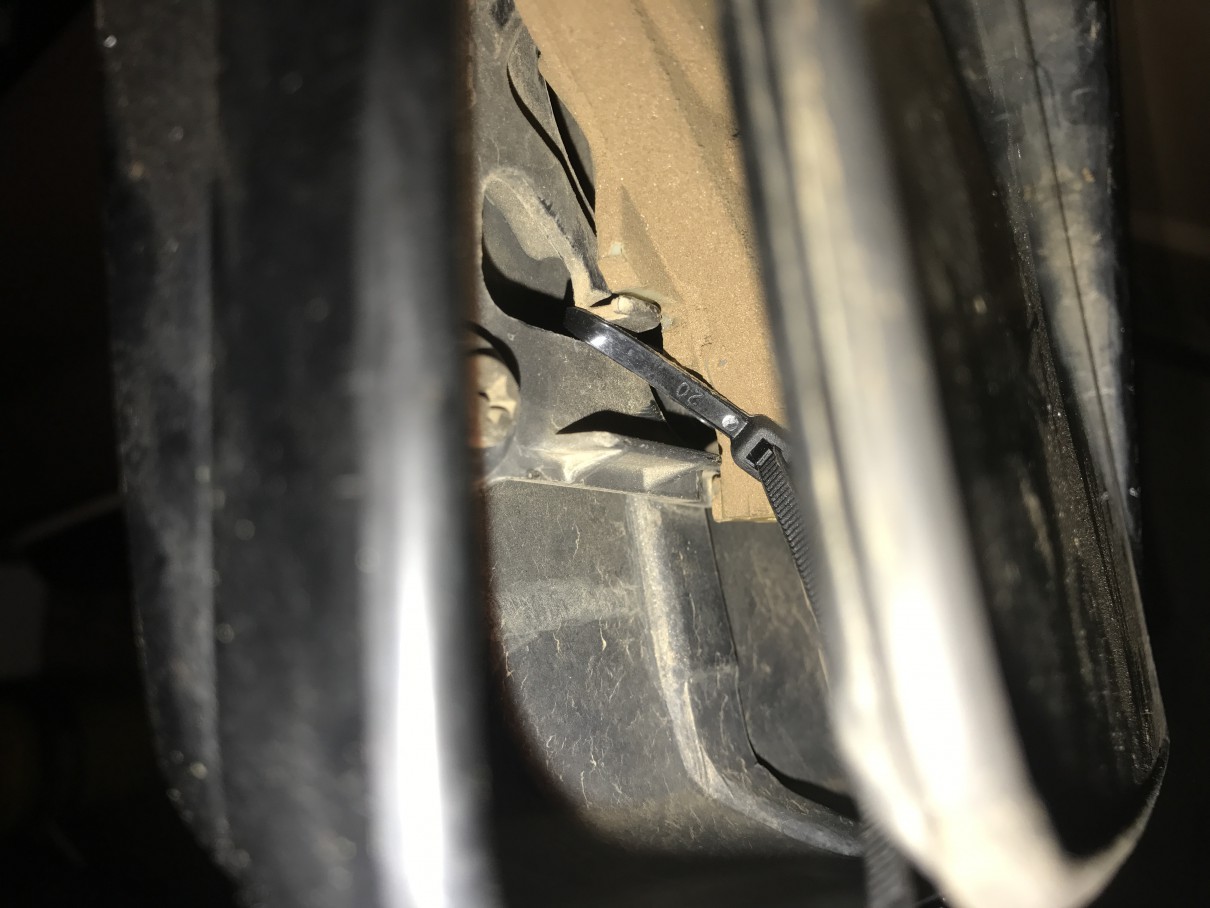

Put 2 cable ties through the mirror housing, there is a metal bracket on the inside with sufficient space for the cable ties, Each one as close as possible to the original hooks and latch them around the plastic mechanism on the mirror.

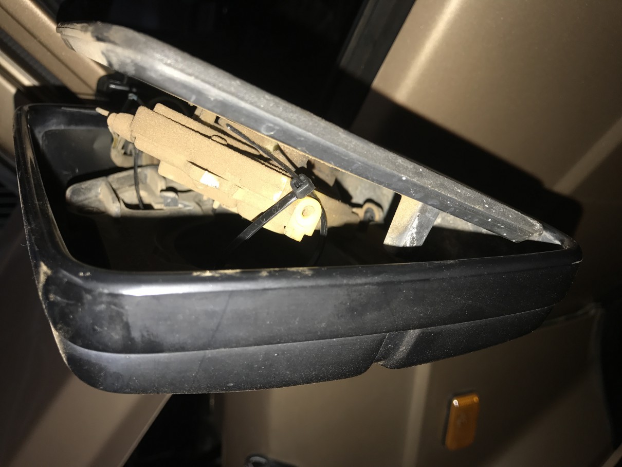

Put the mirror back in place, tighten the screw and tilt the mirror forward for best access.
Then carefully tighten both cable ties with the needle nose pliers and cut of any excess.
