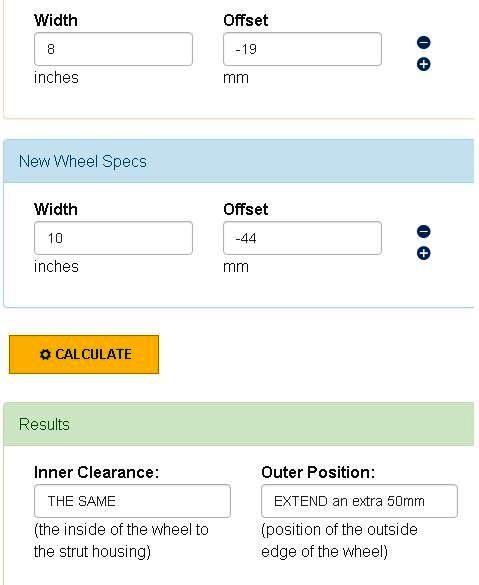

I am considering getting 15" wheels to fit onto my 4500GRX.
But I am unsure which size and offset would be the best options, without having to use spacers.
Want to fit 33x12.5r15 mud terrains on them.
I see that the recommended rim width for this size tyre is 8.5-11j.
Would a 8j rim be wide enough? Or would it better to get 10j?
From what i read on some of the aussie forums, it seems that the correct offset would be:
1. -19 on 8j rim
2. -44 on 10j rim
Can the guys using 15" wheels on their Patrols please comment on what type of rims/mags they are using? (width/offset).
If I can fit 15" wheels without having to worry about spacers then it would suite me perfect. :thumbup:
https://www.1010tires.com/Tools/Wheel-Offset-Calculator#
