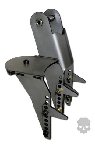

My other option is to make the top bucket adjustable on a rail type setup till I got it pinned down and then just weld when the height is sorted. But I don't like that setup much.
Something like this
Something like this
