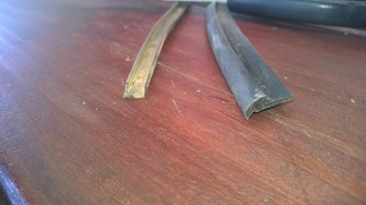

Right. Part numbers and similar.
Beading Trim, I purchased from Pro Auto Rubber in Pretoria. 328 Rebecca Street, Pretoria. 0123272757.
Part number: PR178.
Description: TRIMMING EDGE.
Cost: R16.93 per metre.
The pro auto beading (right) has a slightly different profile to the standard Patrol beading (left), but I think it will work.

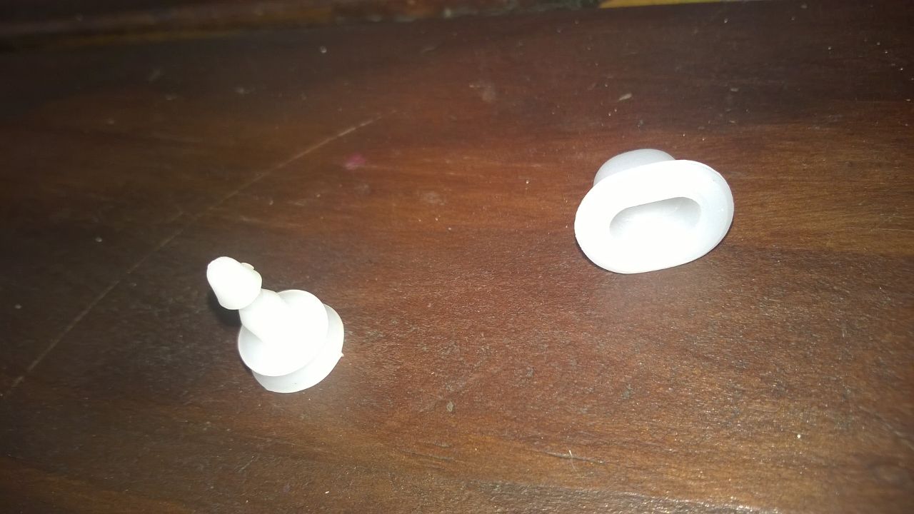

Trim clips, I purchased from PBS Paints. Corner Charlotte Maxeke & Ketjen street, Pretoria. 0123277022
Male clip (left)
Part number: 832.
Description: CLIPS-NISSAN WHEEL ARCH CLIP.
Cost: R5.02 per clip.
I also bought a few female clips (ie: the bit that sits in the door). But I bought considerably less because mine all seem to be good, and they're considerably more expensive.
Female clip (right)
Part number: 839
Cost: R19.74 per clip.

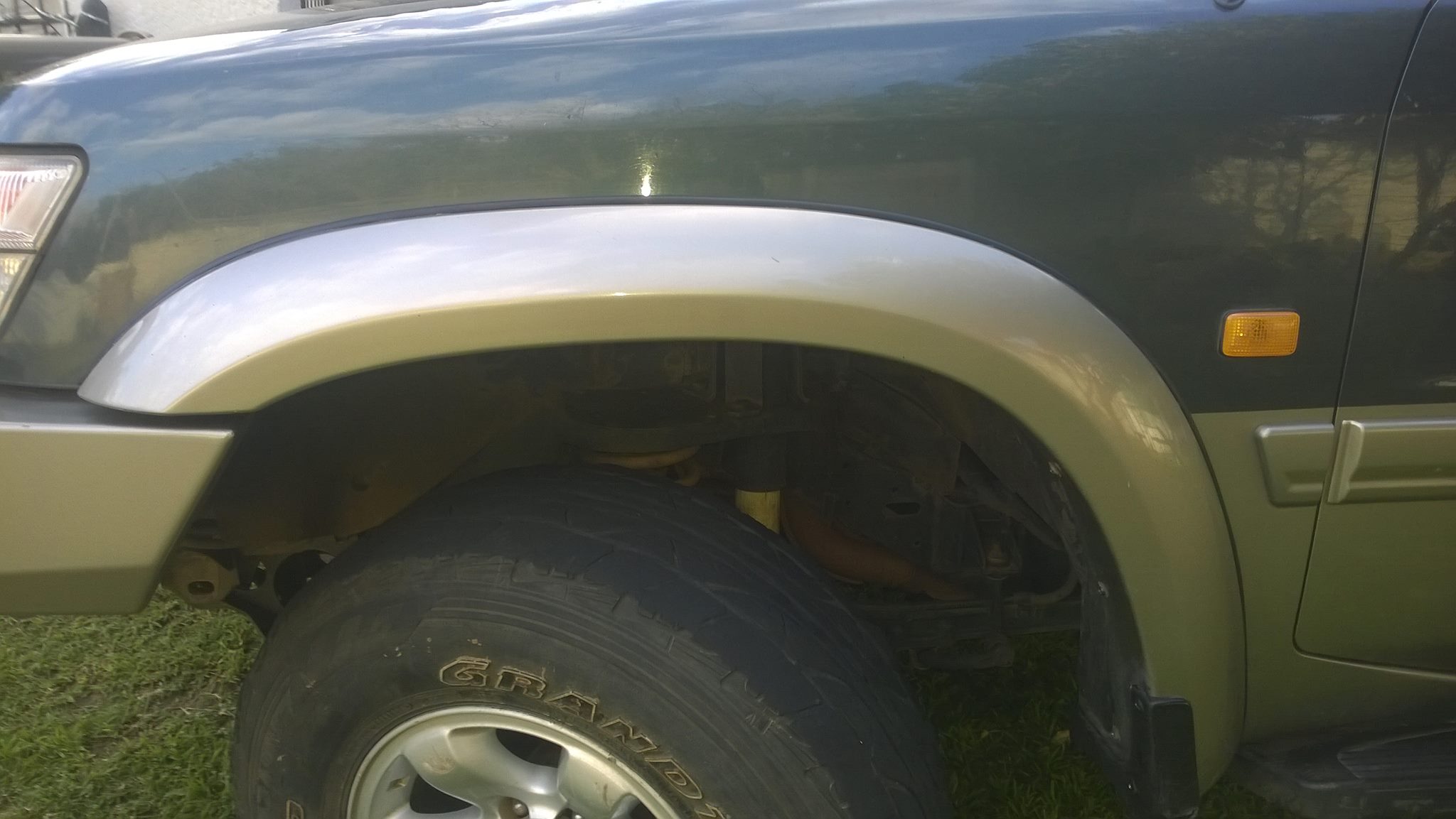

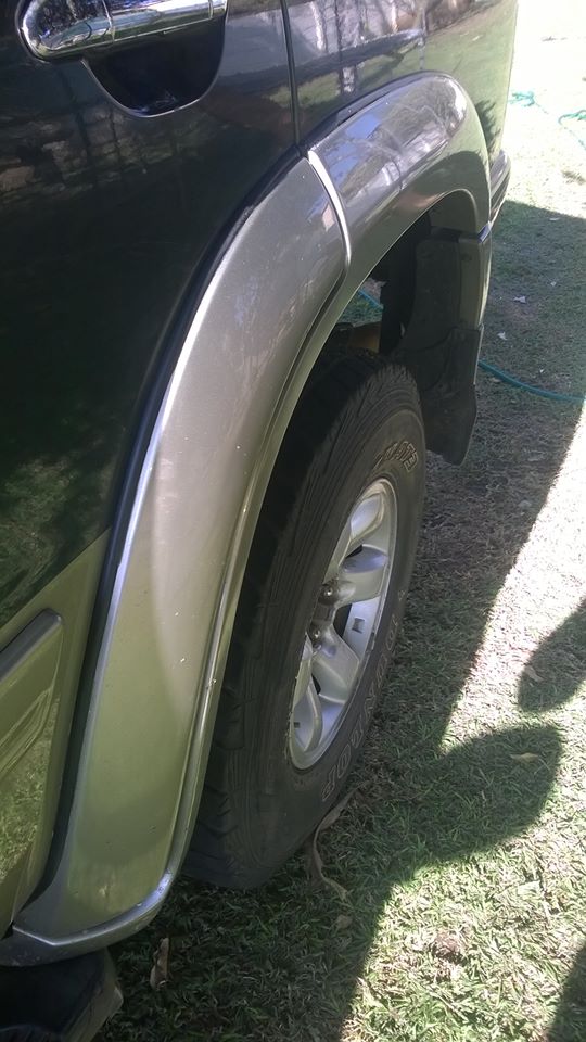

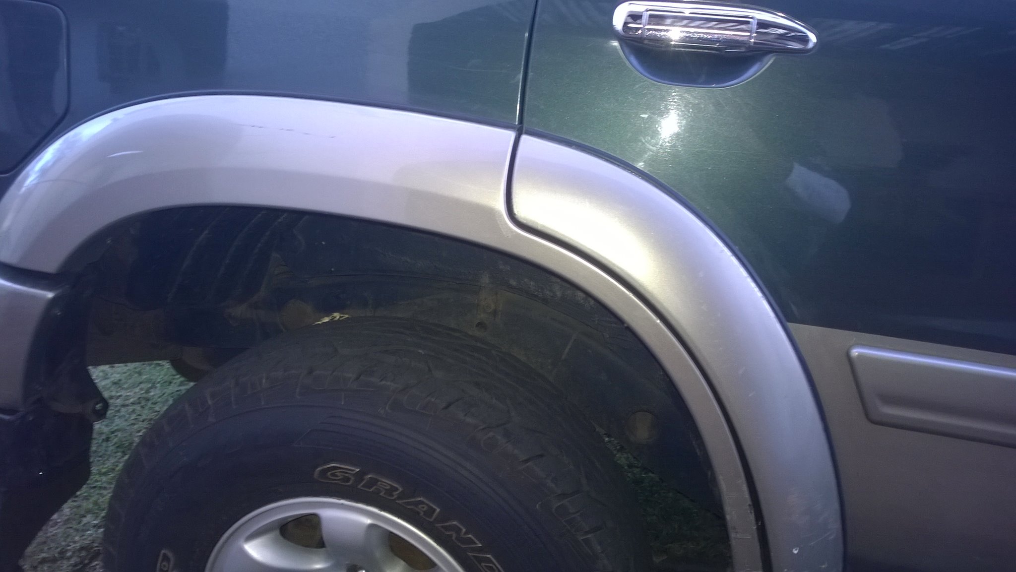

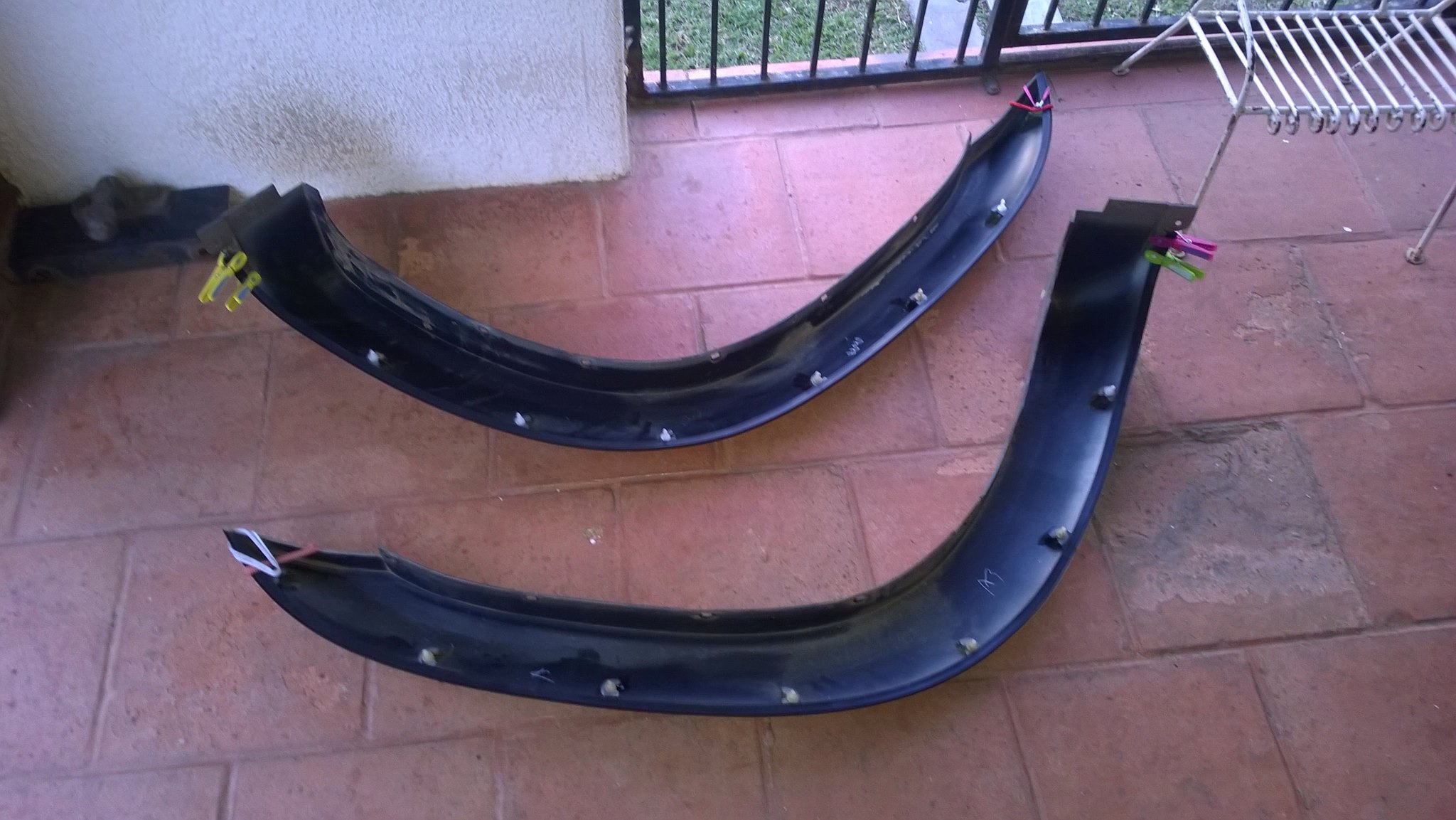

Right. I spent the weekend doing some serious panel beating, as well as replacing the trim beading.
I used silicon - it worked well. I think the annoying thing is that it takes a bit of time to set. That is however, where all my wife's washing pegs and "haar-rekkies" were very helpful.
I've taken a ton of photos, and I've made notes of all the "gotchas" when removing the trim panels. There are a few. For example, there are three different types of "female" clips and two different types of "male" clips for the panels, but I've just got to get around to sorting them and uploading them.
Overall, once one gets the hang of the stuff, it really is not a massive job. A few teaser photos in the meantime.
