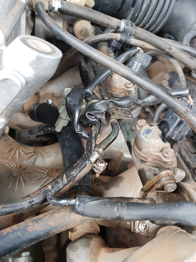

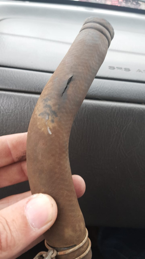

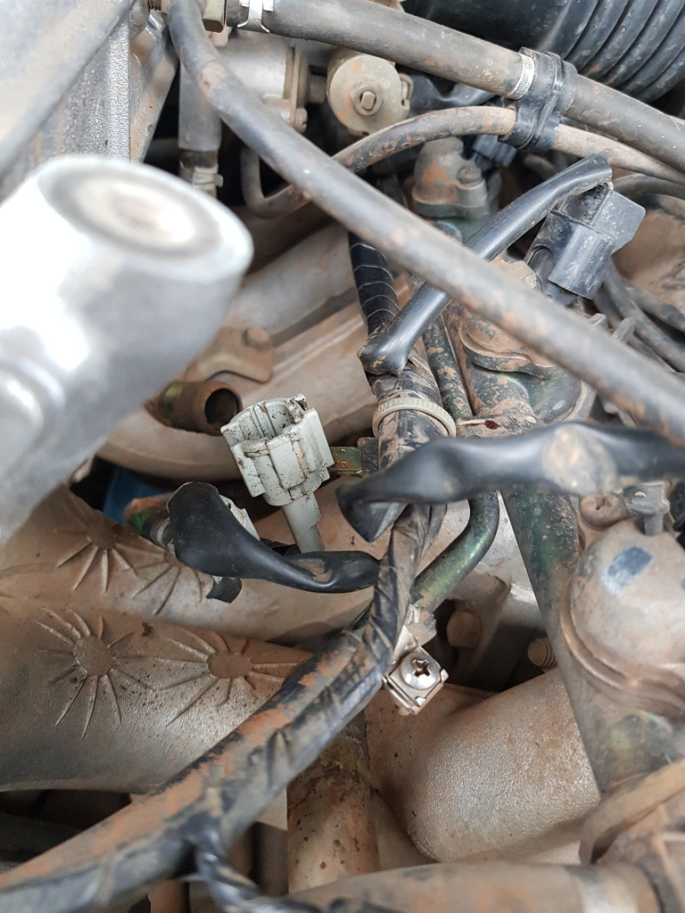

Refilled water, drove over Saartjiesnek. On the way, Etienne (who was travelling behind me with the 4.8) called me to tell me water kept gushing out from underneath the vehicle, and I'd need to stop at the garage just on the other side of Saaartjiesnek. Engine temperatures remained well within reason, but to be safe, I switched off the motor and let the truck free downhill to the next garage. When we got there, we popped the hood and removed the engine cover to spot that the hose running from the thermostat block had split and was pushing water out all over the place.
So we parked the car, removed the offending pipe and drove through to Brits to find a spare...
A quick stop at the first of the local spares shops provided a spare that would work, and we fitted the thing.

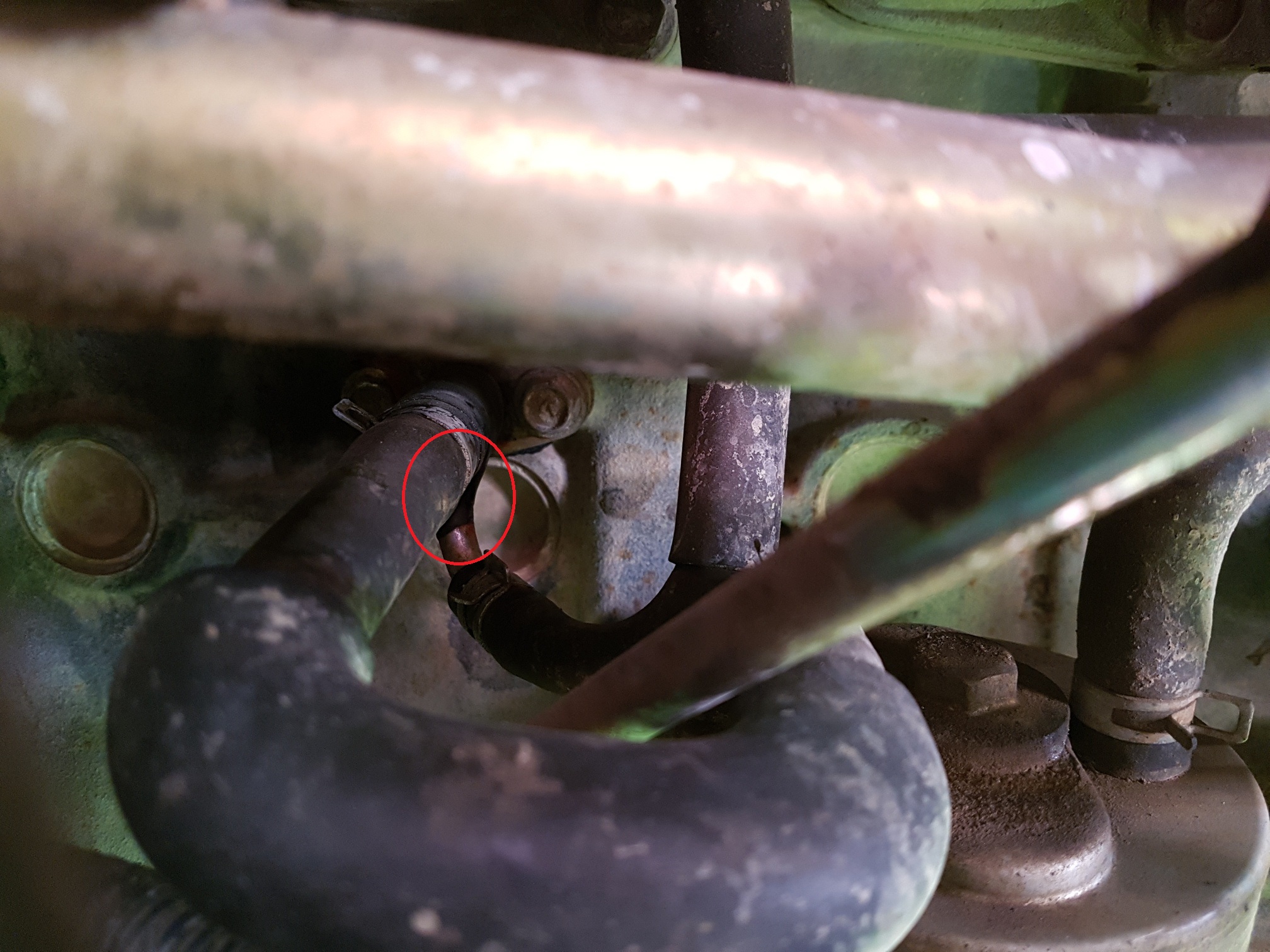

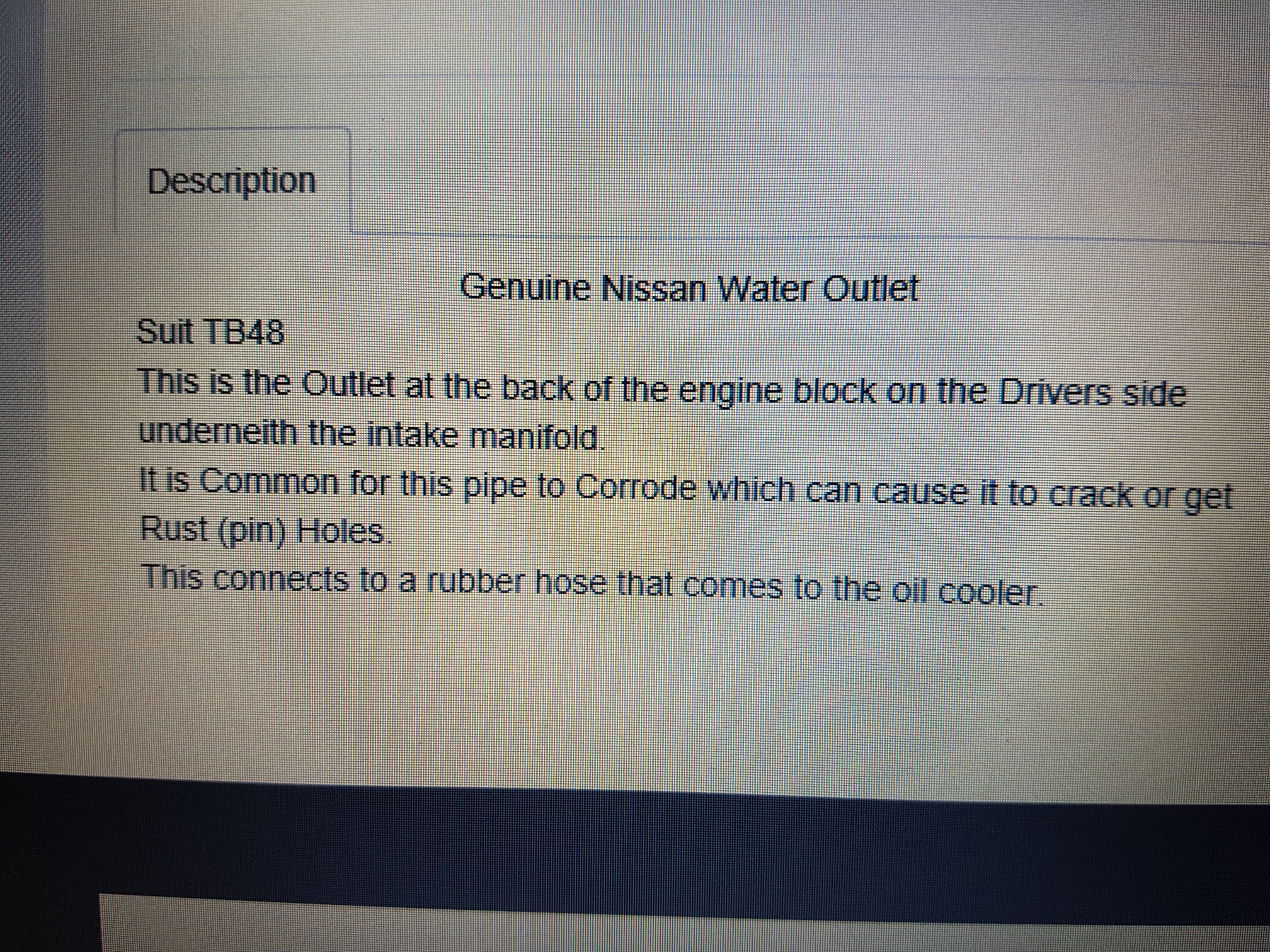

There is a water outlet on the right hand side of the engine with 2 hoses connecting to it. The thick hose connects to the oil filter housing and I am not sure where the thin hose connects. It goes up through the intake manifold. We found that there is a small hole where the thin pipe on the outlet connects to the thick part. My son and I removed the outlet (not an easy task) and fixed the hole with Q-bond and a couple of layers of stretch and seal tape. We started driving again and the car immediately started to run hot. I stopped and called Graham who helped me to get the bleeding screw on top of the engine. Thank you again Graham.After bleeding out the air the car ran fine for the rest of our trip of 3500km (I will write a trip report at a later stage later). I still have to replace the outlet and I also want to replace all the hoses.
