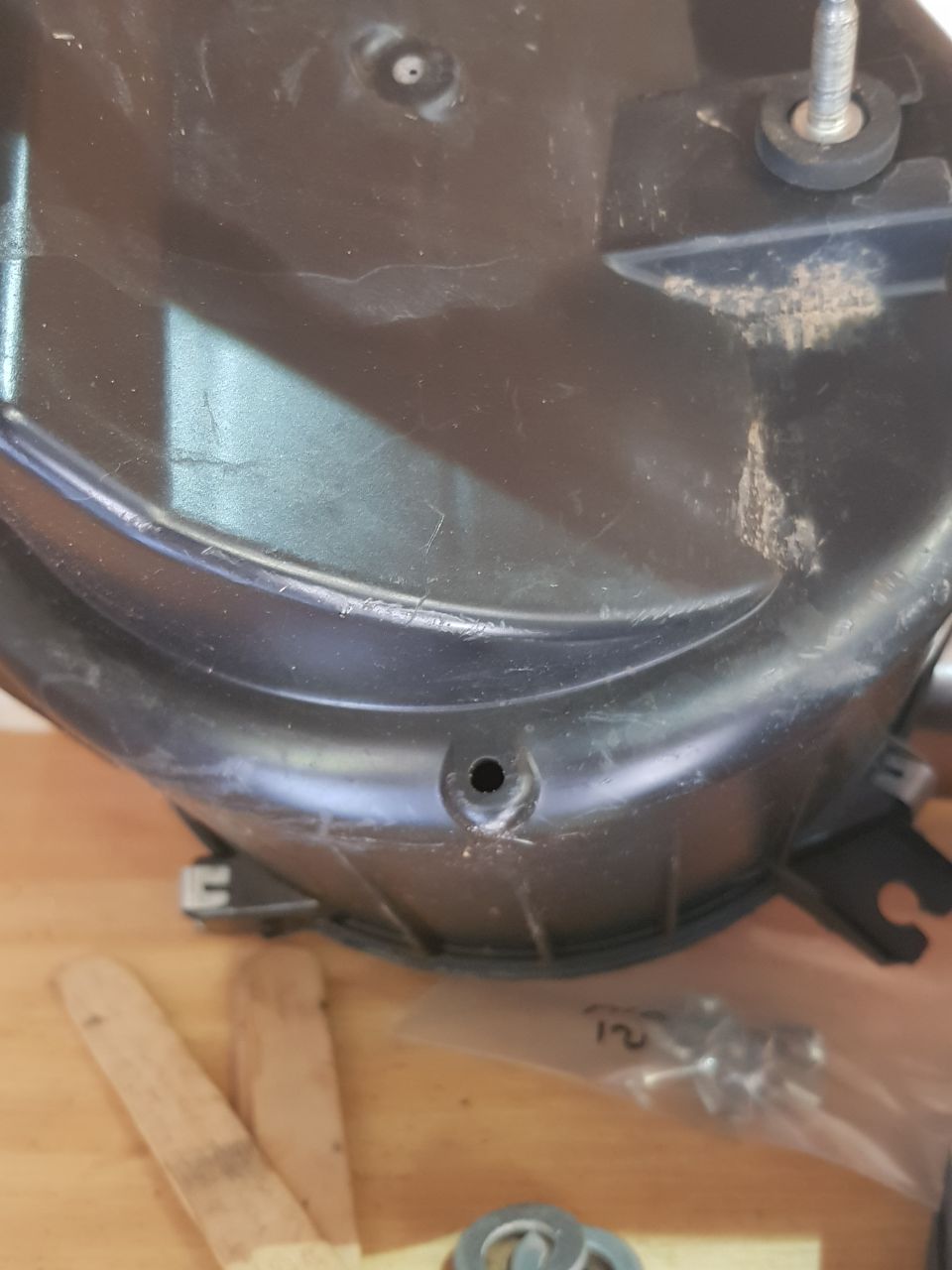

by Peter Connan
This is what it looks like, seen from outside.
I am prett6 sure that, at low engine speeds, this hole will ne able to drain water. At higher engine speeds, probably not.
