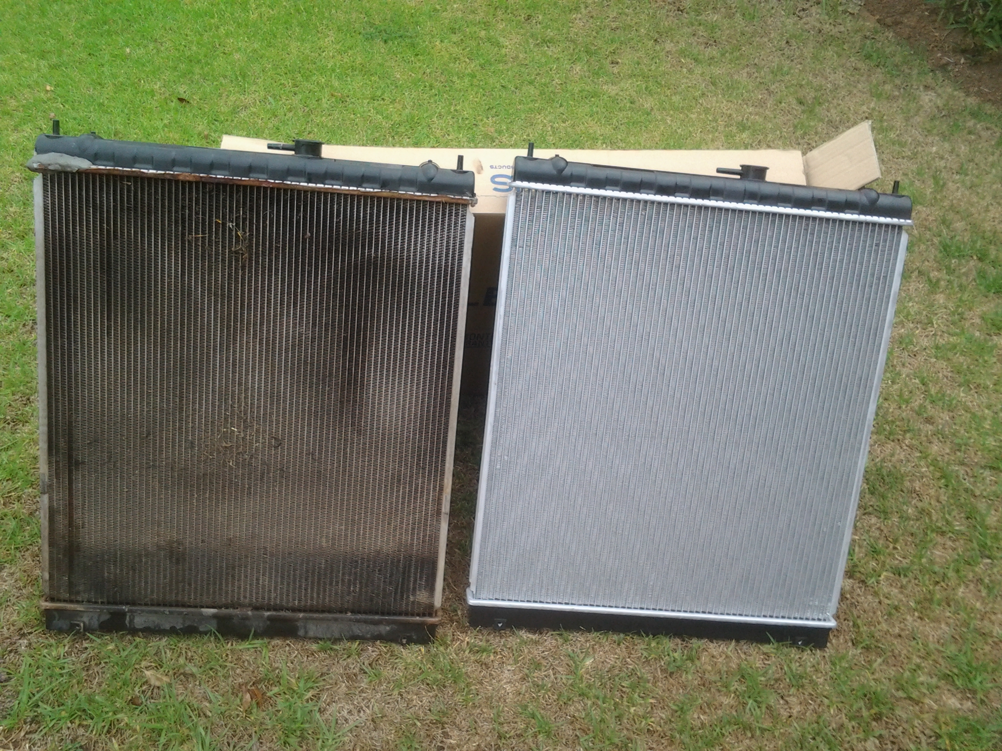

My well maintained cooling sytem decided to show me the middle finger after ten years service :doh:
Saw this wet patch in the garage and after investigating noticed that it sprung a leak under pressure between the aluminium body and plastic top tank.
Nissan wants R14k for a new one! Blêrrie thing must be gold plated :surprised:
Surely there must be better/cheaper options - any sugestions? :think:

Using Tinus's contact I got a brand new radiator delivered to my front door for R3200. Only difference I can see between the original and the new one is the Nissan badge which means you pay R10 000 for the badge!
Hardest work was removing the bashplate - the rest is just pop out old and pop in new...and remembering where the bleed screw is when refilling with antifreeze :thumbup:
