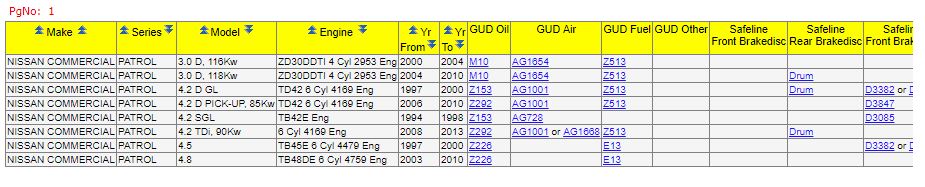

Is there a GUD air filter for the TB45?
Marino4x4
Posts: 520
Joined: 19 Oct 2011 12:15
Full Name: Marinus Potgieter
Nickname: Marino4x4
Home Town: Bloemfontein
Current 4x4: Nissan Patrol
Location: Bloemfontein
Has thanked: 17 times
Been thanked: 87 times
Re: SERVICE ITEMS
Post by Marino4x4 »
Unfortunately not. Only Nissan part. I can get them from Australia, but not cheaper than what you can get them from Nissan. Was R720 for the last one I got.
Nissan Patrol Filters.JPG (60.48 KiB) Viewed 22122 times
