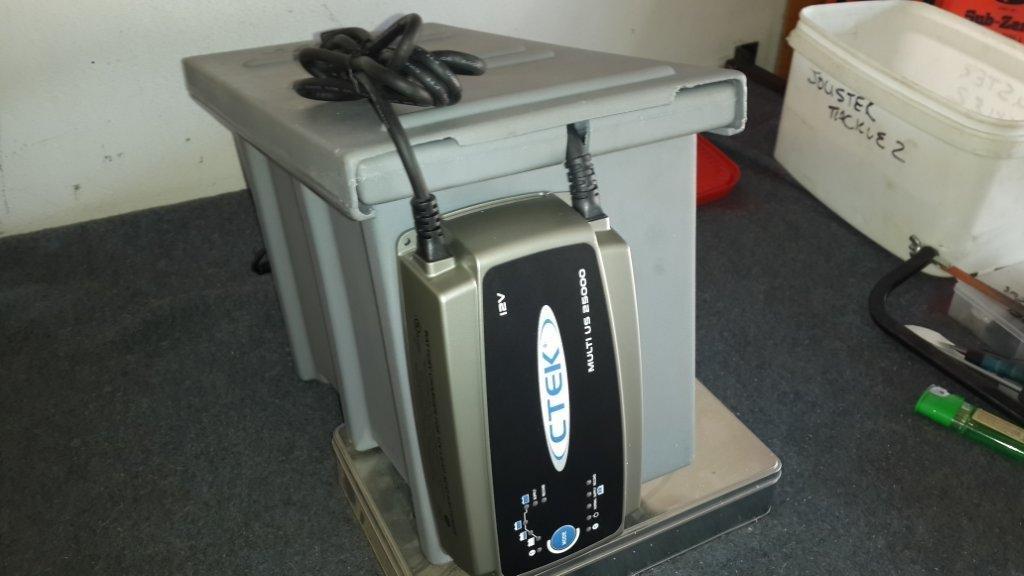

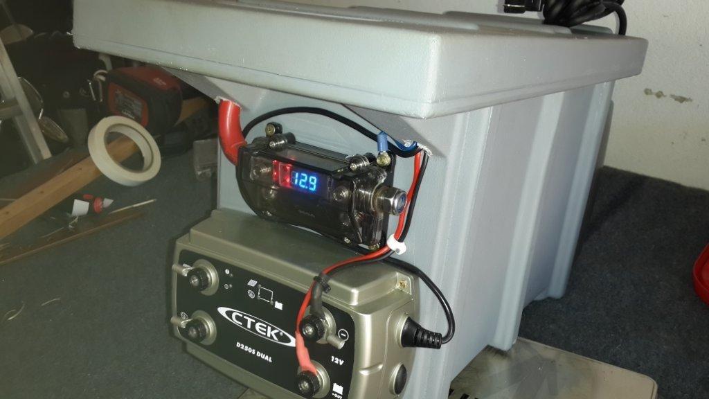

.... so what I read from Tinus is that if you dont use a DC-DC for AGM and LeadCrystal, you will never get much better than around an 80% charge... even worse if the battery is in the back.
DC-DC is way to go, but dont forget a AC-DC as well!
This is the ideal set-up in my view:
- 20140316_104039.jpg (63.4 KiB) Viewed 2976 times
- 20140316_104145.jpg (65.01 KiB) Viewed 2976 times
