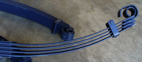

NIKOLAI !!!!!!!!!!!!! hellep toch jonge - ji is mos toch leuk, niet waar???
Ek is opsoek na PARABOLIESE springblades vir die SAFARI [ek dink die '100' daar by julle.
Dit lyk so:
Dit lyk so:

Kagiso II wrote:NIKOLAI !!!!!!!!!!!!! hellep toch jonge - ji is mos toch leuk, niet waar???
Dit lyk so:
Goededag! Heb je een VIN nummer voor mij? Zijn voor voor neem ik aan? slechts 4 bladeren ? Of is de foto alleen ter illustratie??

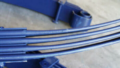

Nikolai, those are not original springs. They are aftermarket springs and are called parabolic springs. With parabolic springs, each leaf's thickness reduces from the middle to the tip instead of achieving a reduction in thickness of the overall pack by sandwiching many leafs of different lengths. The parabolic spring packs always have relatively few leafs and they are spaced away from one another. Parabolic springs have advantages in terms of articulation and ride comfort (by eliminating interleaf friction and by achieving more optimal thickness distribution so that every bit of the spring pack deforms an almost equal amount). One of the most well known manufacturers of aftermarket parabolic springs is Heystee in the Netherlands.

Hello Gerrit! Thanks for the information!!! Also good to learn!! We do have contact with Paul Heystee in Holland.Gerrit Loubser wrote:Nikolai, those are not original springs. They are aftermarket springs and are called parabolic springs. With parabolic springs, each leaf's thickness reduces from the middle to the tip instead of achieving a reduction in thickness by sandwiching many leafs of different lengths. The prabolic spring packs always has relatively few leafs and they are spaced away from one another. Parabolic springs have advantages in terms of articulation and ride comfort (by eliminating interleaf friction and by achieving more optimal thickness distribution so that every bit of the spring pack deforms an almost equal amount). One of the most well known manufacturers of aftermarket parabolic springs is Heystee in the Netherlands.

[die foto wat ek geplaas het is net ter illustrasie - ek sou self nie meer as 3 blaaie op LOBO [die 1981 SAFARI] wou plaas nie [ek ry nie sware vragte nie - maar EK wil gerieflik ry - en woes kan "off road"
